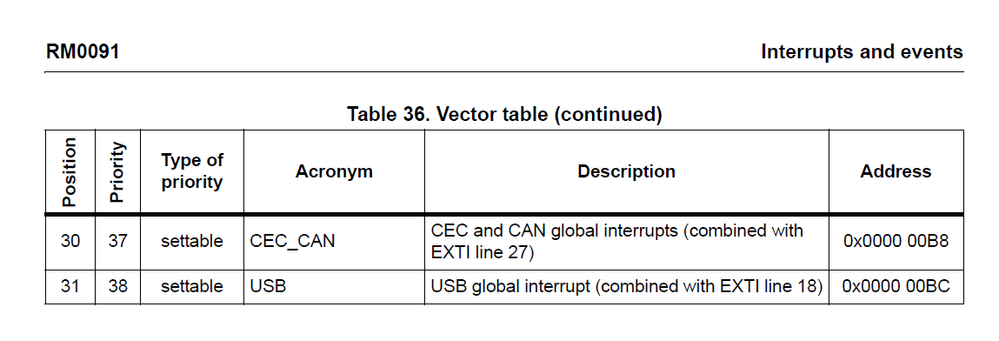

I am asking this because when referring to the Reference Manual I see that the vector table resides at addresses 0x0000 0000 to 0x0000 00BC:
and the end of the table:
But if I go the the linker script file I see that the vector table is actually located at the flash memory section:

What am I missing? The document says that it starts from address 0x0, while the Linker Script file says it starts at the first flash section address address.

In STM32F0 the flash is aliased to 0x0 if booting from flash.
Posted on June 26, 2018 at 14:18
The CM0 parts it is always at address zero, other hardware then allows for the mapping/shadowing of RAM, FLASH or ROM at that address.
To use an alternate table (ie IAP loader + application) you would reserved some space at the base of RAM, copy your table there, and then remap the RAM so it appears at both 0x20000000 and 0x00000000
For the CM0+ parts the VTOR is available and you can program in an aligned tabled, ie SCB->VTOR = 0x08004000
