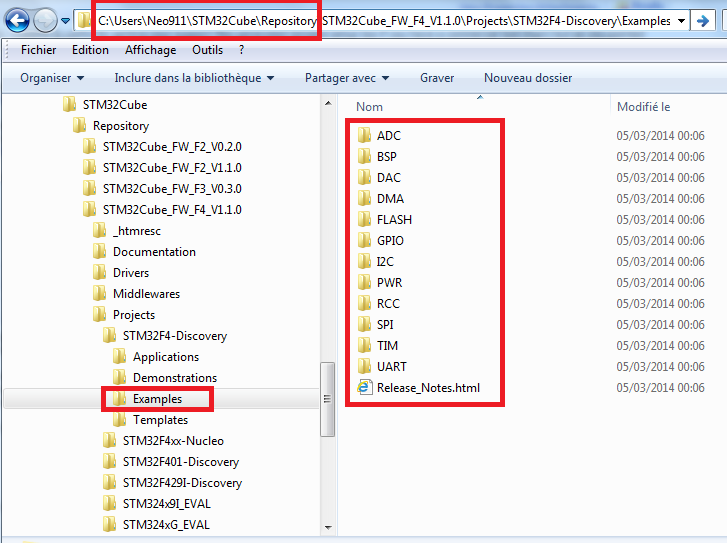

sandtime
Posted on April 30, 2014 at 18:57
Thank you all for your help.  I think I figured out a big part of the problem.  All the sources, if they're not giving the dead link, point to the STM32 Cube.  And it's tough to figure out the difference between the CubeMx vs the CubeF4.
Once I figured out that the examples are in the CubeF4, that led to my next bit of frustration - because I downloaded the F4 package *through* the CubeMx library installer.  So I thought I had it.  What I didn't realize was that when you download the CubeF4 through the CubeMx, you don't seem to get the whole thing.  The libraries came through just fine - but all the examples, demonstrations, and applications are left out.
So even though I had already grabbed it through the CubeMx, I apparently had to download the CubeF4 all over again as a seperate file.  Once I did that, I finally had access to the examples.
This was not well done on ST's part.
Regardless, thank you all for your help.  I truly appreciate it.

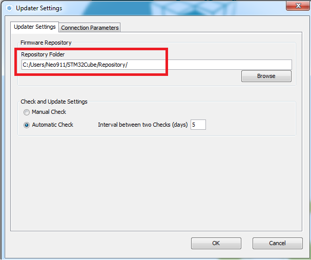

neo911
Posted on May 01, 2014 at 09:54
As far as I can see, the CubeMx library installer, after downloading it, puts for instance the STM32F4 package in your ''repository'' (see User Manual, 3.5.1, ''Updater Configuration''). One can get the default settings by selecting the ''Updater settings'' choice in the ''Help''menu.
As a result, I can see in that folder the contents of STM32F4, no need to get it separately.
Rgds.
