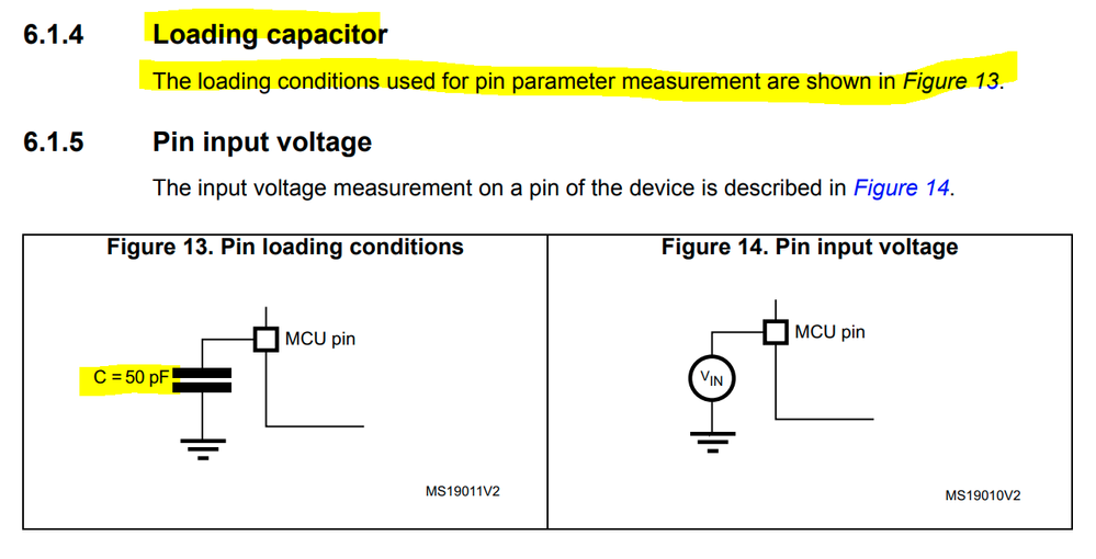

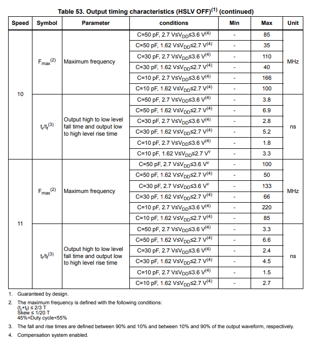

what capacity is this
A.Caliskan
I couldn't find it in the datasheet,, what capacity is this0693W00000GZTUOQA5.png
It's described in the datasheet:

Uwe Bonnes
Principal III
It is the load capacitance, resulting form the connected inputs and connecting copper traces
