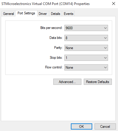

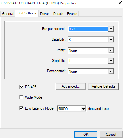

I am trying to make a USB-Serial converter. I need some help about communication via RS485. Device Manager properties of a serial converter different brand shows RS485 checkbox and works fine. But STM32 VCP doesn't show it. How can make it work, in driver level what should I do? I can send  data with VCP com but I can't receive now.

I'd look at the .INF and check what drivers and DLLs it might load, and if it sets any registry entries or provides a property sheet for the dialog.
You might also want to inspect the USB descriptors passed by this other device.

Bute, i figure out the same problems at this time.
Is there any solution for this?
I need to set the virtual comport to use rs485, but in the new driver (new OS) there is no more this checkbox present.
