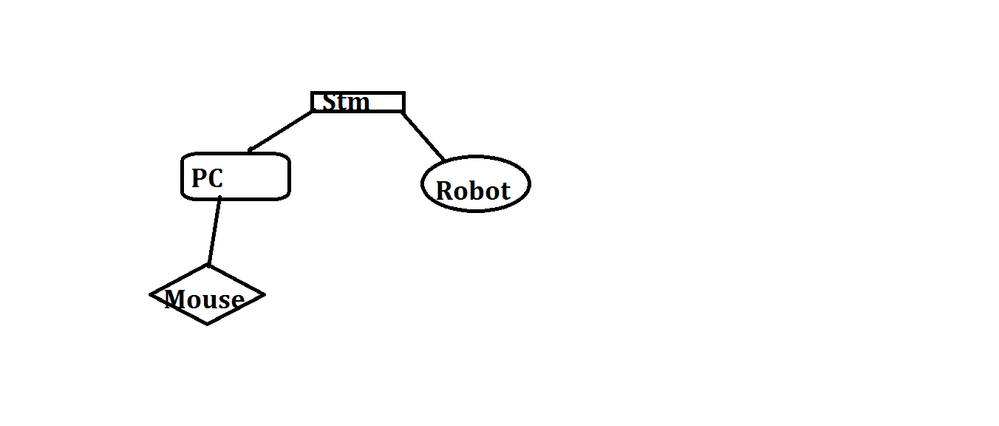

Here is what i want to do, control robot arm with mouse(Connected to Pc) buttons and cursor,So what i understand is, PC will be host and stm a device(Am i right?).Secondly is it possible what i want to do or should i interface mouse with stm rather then PC.
