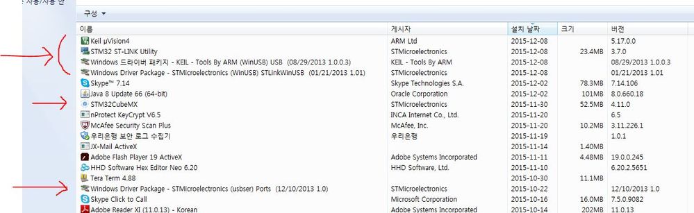

I've seen the USAR2UNCLEO401.hex program run ok in my PC, but after removing a driver I cannot reproduce it. I tried re-installing the programs, updated the board's firmware but cannot progress further.
Here is the driver install state of my PC.
Does my software installation look normal?
Posted on December 08, 2015 at 15:43
The is working for me
Win7 x64
V2.J24.M11 (from ST-LINK Utilities 3.7.0)
ST-LINK 12/10/2013 1.1.0.0
STLink Virtual COM Port 12/10/2013 1.0.0.0

the same with me, but when I add the latest VCP (latest is V1.4.0-10/20/2014, not your version is V1.0.0.0 2/10/2013) I cannot find COM port.
I wish to try VCP V1.0.0.0. Do you have the install file for it yet? (for V1.4.0 it is stsw-stm32102.zip)

Hi, clive1,
I tried the same project on my colleague's win7 computer, it first worked (can see print on serial port window). With the same program programed on the board, I tested it on my win7 machine but didn't work. I connected the board on my linux machine and it works! So it's not the problem of any program on the evaluation board but the driver problem on win7 machine as I suspected. I then tested the board on my colleague's computer but it doesn't work now. Looks like something changed after the first execution..
