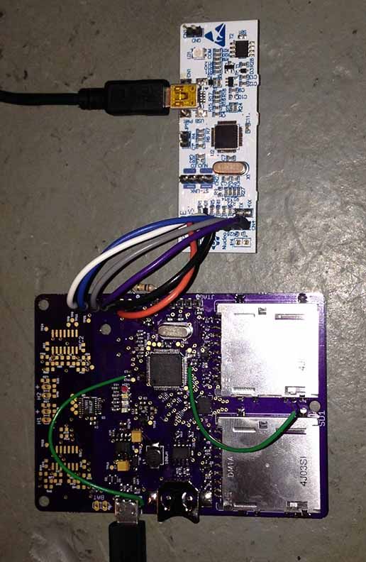

This is my first project with an STM part. I have started development on a NUCLEO board with an STM32F401RE chip and I'm programming/debugging using the onboard STLINKv2. So far firmware development has gone well.

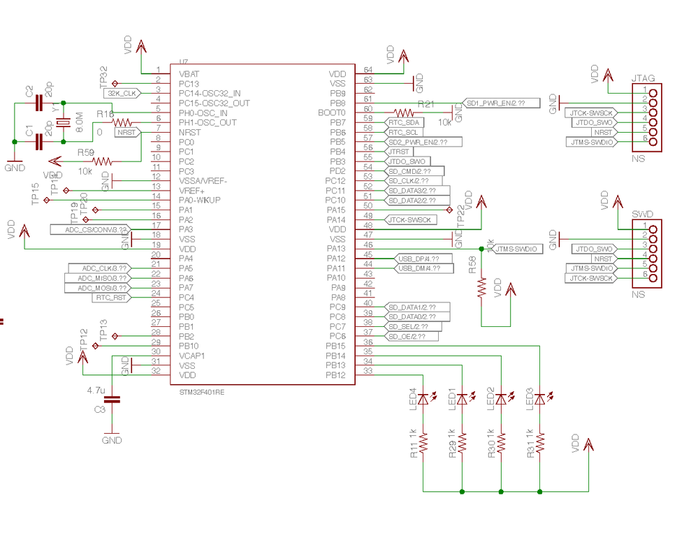

I designed a new board with the same chip (STM32F401RE) and I bought a second NUCLEO board to harvest the STLINK from.
I cannot communicate with the new pcb at all -- from either STLINK, and I'm afraid I might have done something wrong in my schematic.
I am attaching the schematic and a picture of my programming setup.
Some notes:
1. I have removed the CN4 jumpers on the STLINK board
2. I have tried with only SWDIO, SCK, GND, and VDD  (also trying with SWO and NRST)
3. I have tried various configurations of BOOT0, BOOT1, although by default BOOT0 = GND.
4. I have tested continuity all the way between the pins and the STLINK and made the wires shorter.
No matter what I do, when I plug in the STLINK board, the NUCLEO drive contains a file called fail.txt, which contains the text ''SWD ERROR''. And I am unable to connect or communicate with the target board from the STLINK software.

Posted on July 24, 2015 at 02:19
Can you attach a better focused/resolution picture, rather than in-line (100kb) one?
Check the voltage on the VCAP pin, and the NRST pin.
Can you use the ST-LINK Utilities rather than the on-board mass-storage method?
The board looks to have it's own supply, if so *don't* connect VDD to the ST-LINK

Posted on July 24, 2015 at 15:54
The functional connections to the SWD are incorrect. E.g., GND is pin 3. Check Section 5.2.4 in the Nucleo reference manual.
Cheers, Hal

Posted on July 24, 2015 at 19:45
Thank you for putting me on the right track. I checked VCAP1 and saw that the 1.2V rail was failing to come up properly. I tried replacing the capacitor on VCAP1 with the one from my spare NUCLEO board without any change. After reviewing the reference manual I found that VDD - VREF+ cannot be greater than 1.2V. I had VREF+ unconnected.
After connecting VREF+ to VDD the chip powered up successfully.
V
DDA
V
REF+
< 1.2 V

Hi Hal,
Thanks for the review. You are, of course, correct. But I am already re-arranging the wires in between the boards to correct this.
Posted on July 24, 2015 at 19:51
I was looking for VDDA on your design, assuming that's the VREF+. The Power-On-Reset circuit and PLL are run off the analogue supply. The parts won't start without it.
Pin 13 on the 64-pin devices is VDDA, +VREF is connected to it internally.
