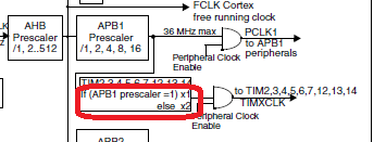

Posted on March 15, 2013 at 10:12
I can't understand why 3MHZ i think
/* PCLK1 = HCLK/16 */
  RCC_PCLK1Config(RCC_HCLK_Div16);
generates 1.5MHz?
From the Clock Tree in the Reference Manual
joesoftware
Posted on March 15, 2013 at 10:34
Thanks
for your patience.
I forgot that
apb1
doubles the
clock
timers
I will read again timer chapter, i think now it will be more easy.
Thanks
Posted on March 15, 2013 at 11:06
The description is a bit deceptive, it doesn't really double it, rather it takes a clock from further up the divider chain. So the operation isn't /16 then x2 but rather just /8
