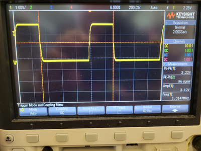

I am attempting to get a PSSI interface to an ADC working on the STM32N657.  Due to the speed, it is necessary to use DMA.  I'm seeing an over-run error from the error call-back.
The clock is produced from one of the PWM timers, presently set to 1MHz, but will eventually need to be increased to 10MHz.  This is tied to the PSSI clock input.  The clock signal looks very good:
