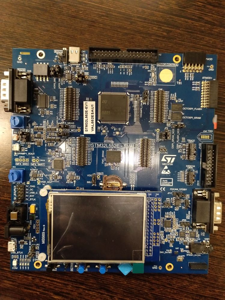

I trying to test Demostration Firmware(*1) for my STM32L552E-EV evaluation Board, and in the documentation for this Demo is written:
  • This demonstration has been tested with STM32L552E-EV (MB1372-C02) evaluation board and can be easily tailored to any other supported device and development board.
  • Copy Binary\SD_card content at the root of the microSD card
@note Jumpers setup on MB1372_L552ZEQ-C02:
  JP1 : OPENED    / JP4 : 1-2 (LEFT)  / JP5 : 1-2 (LEFT)  / JP6 : CLOSED
  JP7 : 1-2 (RIGHT)  / JP8 : 1-2 (LEFT)  / JP9 : 1-2 (DOWN)  / JP10 : CLOSED
  JP11 : 1-2 (LEFT)  / JP12 : 1-2 POT    / JP13 : 2-3 OPAMP   / JP14 : OPENED
  JP15 : 1-2 (VDD)   / JP16 : 5V-STLK    / JP17 : 1-2 (RIGHT)  / JP18 : OPENED
  JP19 : OPENED    / JP20 : OPENED    / JP21 : OPENED    / JP22 : OPENED
  JP23 : OPENED    / CN12 : OPENED    / CN23 : OPENED
The problem is that my Evaluation Board is a different version. My Evaluation Board has this Labels:
  • Sticker_Top: STM32L552E-EV1
  • Sticker_Bottom: MB1372_L552ZEQ-B01
  • PCB Serigraphy 1: STM32L552E-EVAL
  • PCB Serigraphy 2: MB1372B
This is my Board (attach an image):
In my Board:
  • JP4 have only 2 PINS. How is the corret confuguration OPEN or CLOSE?
  • JP6 have 3 PINS. How is the corret configuration 1-2 (UP) or 2-3 (DOWN)?
  • JP23 does not exist or I don't find it.
I downloaded Resources from:
https://www.st.com/content/st_com/en/products/evaluation-tools/product-evaluation-tools/mcu-mpu-eval-tools/stm32-mcu-mpu-eval-tools/stm32-eval-boards/stm32l552e-ev.html#resource
  • MB1372 Board design project files 1.0 15.91 MB
  • MB1372 Manufacturing files 1.0 21.98 MB
  • MB1372-L552ZEQ-C02 Board Schematic 1.0 42.43 MB
This Resources are not for my board neither, but if I search for these JPs in these docs JP4 have only 2 PINS too, how it will be "JP4 : 1-2 (LEFT) "
Where can download the resources for my board version?
