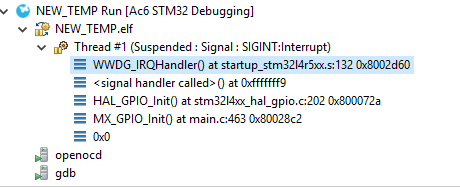

2018-06-01 1:21 AM
Thanks for the support.
I have taken the systemconfig from the sample code provided from L4 Software Stack bundle.
But now when i apply this code what you have provided.
Now its clear that the stack before entering the RESET / WDT.
It looks like this
From GPIO its picking.
May i post some more info after debugging.
Thanks
Phani
2018-06-01 1:30 AM
Sorry, I don't really know what to make of that.
Do you have a watchdog set up? Or is it just entering the Default_Handler dumping ground, which is where WWDG_IRQHandler also weakly binds too?
Are you enabling other interrupts? A TIM or SysTick perhaps?

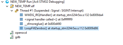

2018-06-01 4:54 AM
Atlast i have identified why the system is getting into RESET.
Case: 1. When i use floating point ABI == hard i get the all the interface ports are working that means the HAL is OK.
Case 2: Keeping the
floating point ABI == hard and trying to link the library of BME680 it wont link asking for VFP register.
This leads to change the floating point ABI from hard to soft ,i..e.., floating point ABI == soft in MCU settings.
Make a build clean and build the whole project and the HAL and all things get build and Linking will be done.
When flashed on to the system
Either SystemConfig gets RESET
or
GPIO gets RESET
or LPUART gets RESET and in one case I2C got reset. which means the HAL compiled when keeping the floating point ABI == soft leading to MCU reset.
So conclusion is to link the lib and getting the MCU in non resetting mode. i need to use floating point ABI == hard.
I need to know how to make STM32L4R5ZI to be linked to VFP register linking in keeping
floating point ABI == hard .
Please let me know how to fix this.
Regards
Phani
