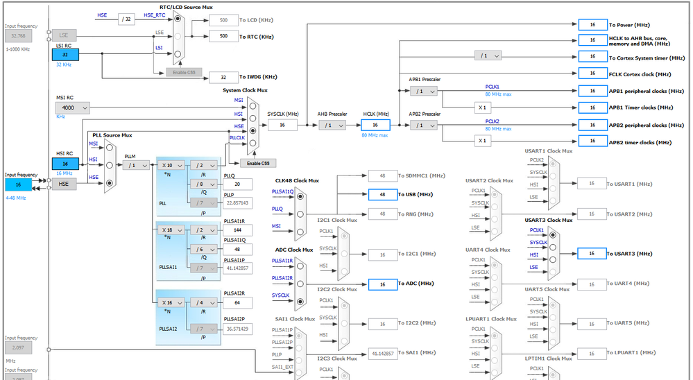

Here is my setting with a SysClock of 16 MHz that work for USB if that might help:
Jerome Godbout
