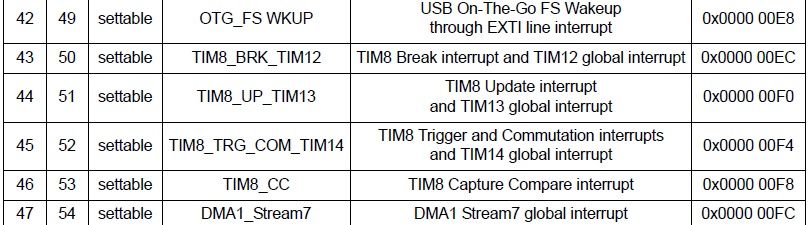

For whatever reason TIM8 doesn't appear to have a CC IRQn on the STM32F446
TIM8_BRK_IRQn = 43, /*!< TIM8 Break Interrupt */
TIM8_BRK_TIM12_IRQn = 43, /*!< TIM8 Break Interrupt and TIM12 global interrupt */
TIM8_UP_TIM13_IRQn = 44, /*!< TIM8 Update Interrupt and TIM13 global interrupt */
TIM8_TRG_COM_TIM14_IRQn = 45, /*!< TIM8 Trigger and Commutation Interrupt and TIM14 global interrupt */
If I enable the CC1 and CC2 interrupts for TIM8, they do appear to trigger in the TIM8_UP_TIM13_IRQn, but they are triggering at the same time as the update so I'm not sure what's going on there. I'm going to try switching to TIM1, which has the correct update and see if the DMA still works.

startup_stm32f446xx.s
DCD OTG_FS_WKUP_IRQHandler ; USB OTG FS Wakeup through EXTI line
DCD TIM8_BRK_TIM12_IRQHandler ; TIM8 Break and TIM12
DCD TIM8_UP_TIM13_IRQHandler ; TIM8 Update and TIM13
DCD TIM8_TRG_COM_TIM14_IRQHandler ; TIM8 Trigger and Commutation and TIM14
DCD TIM8_CC_IRQHandler ; TIM8 Capture Compare
DCD DMA1_Stream7_IRQHandler ; DMA1 Stream7
stm32f4xx.h (446 section)
OTG_FS_WKUP_IRQn = 42, /*!< USB OTG FS Wakeup through EXTI line interrupt */
DMA1_Stream7_IRQn = 47, /*!< DMA1 Stream7 Interrupt */
I think something is hosed up there, TWO TIM8_BRK interrupts. Will consult the DM and RM
Try:
TIM8_CC_IRQn = 46, /*!< TIM8 Capture Compare Interrupt */
‎2015-08-12 5:12 PM
RM0390
‎2015-08-12 7:57 PM
Oh yeah.. wow, good catch! I guess that's what I get for using such a new part :p Oh well I got TIM1 working now.
