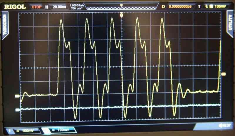

At micro level I am doing fast pulses that should be around 10 nanosecond long, but are 35 nanosecond long as shown in oscilloscope. 0690X00000603H9QAI.jpg This pulse train is generated with the following code

Assembly code for the while(1) loop

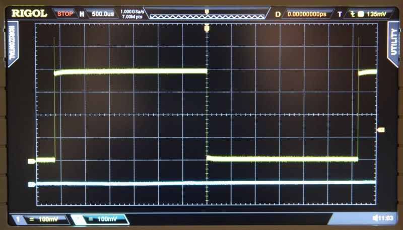

At macro level, I am trying to toggle a pulse with 1000 Hz frequency. The expected pulse width is 1000 microseconds, but oscilloscope shows 3222 microsecond long pulses. 0690X00000603HAQAY.jpg This pulse train was created with the following code.

Note how the 1 millisecond value (180,000) is implemented as 179,200 + 800. I have observed similar results with the SysTick_Handler configured by SysTick_Config. #unexpected-low-performance
