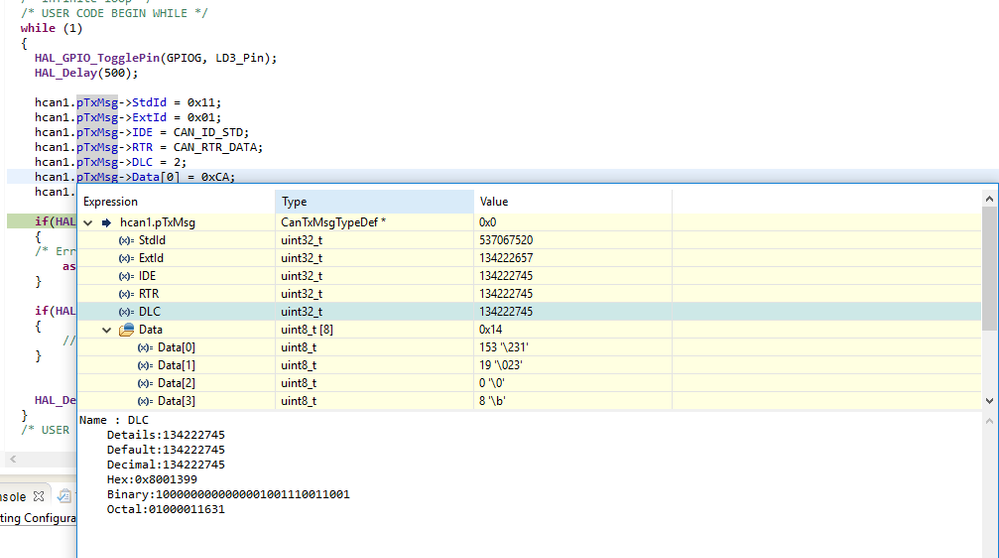

Used the STMCubeMX to generate the code. STM32F429I disco board, CAN running at 500k.
I added a very simple to the loop,
hcan1.pTxMsg->StdId = 0x11;
hcan1.pTxMsg->ExtId = 0x01;
hcan1.pTxMsg->IDE = CAN_ID_STD;
hcan1.pTxMsg->RTR = CAN_RTR_DATA;
hcan1.pTxMsg->DLC = 2;
hcan1.pTxMsg->Data[0] = 0xCA;
hcan1.pTxMsg->Data[1] = 0xFF;
if
(HAL_CAN_Transmit(&hcan1, 10) != HAL_OK)
/* Error */
asm(
''nop''
Then what is received by my Can monitor is 0x240 A6 A7 03 CE Here is a screenshot of the object 0690X00000605LIQAY.png It almost feels like I have a clock issue. But i'm fairly certain I have it setup right.

Just Matt
Posted on February 04, 2016 at 17:44
I feel like an idiot.
static
CanTxMsgTypeDef TxMessage;
hcan1.pTxMsg = &TxMessage;
