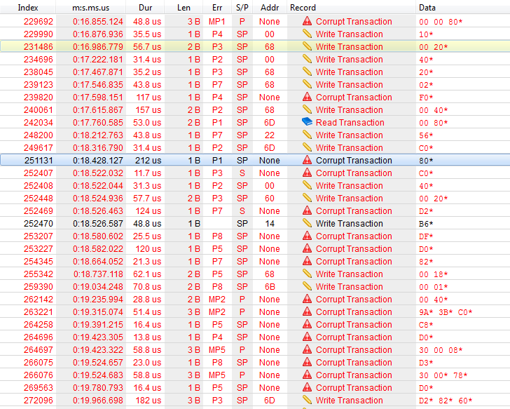

I have been writing my own I2C driver to play well with the RTOS and I have been using a I2C analyser to help me out. After a lot of frustration I have gotten most of it working but what I have discovered is that I sometimes get corrupt transactions. This happens randomly bug generally not more often then once every thousand transactions. As my frustration grew I decided to test the CubeMX HAL I2C driver on my board just verify that it is my code that is doing something strange. However I found out the the HAL I2C driver generates even more corrupt transactions.
The hardware is a custom board with STM32F405 using I2C3 to talk to a MPU9250 sensor with 4.7k pullups at 400kHz I2C clock. Signals looks good on scope so no electrical problem.
Any suggestions?

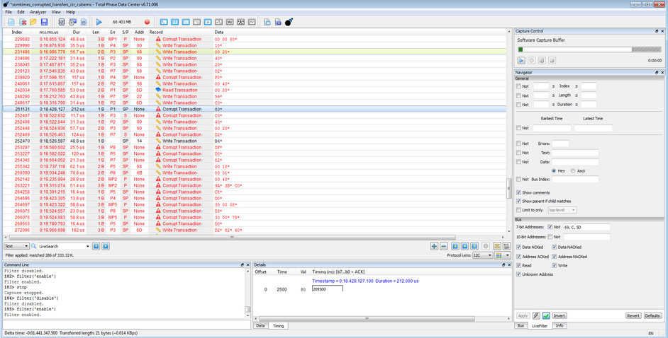

As the image didn't turn out so well I'm adding two new images so it is easier to see what is going on. The test I'm running is just reading 2 bytes from address 0x69 over and over again using the polling function HAL_I2C_Master_Receive (V1.5.1). For this test using CubeMX driver this is the only thing the MCU does. I have verified the same problem on two different boards and next thing would be to test it on a discovery F4 board.

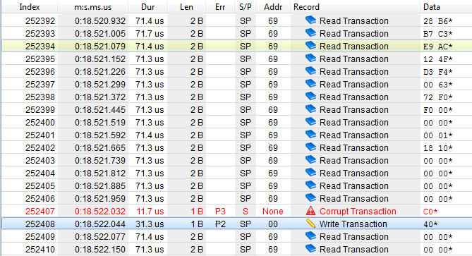

And this is how it looks like when a random transaction error error occures:

After further investigations it looks like it is the analyzer that is the problem. I'm running data center software from totalphase with a beagle I2C analyser in virtualbox and win7 because it doesn't run on Ubuntu. I have now tested running it on a MAC and I don't get these corrupt transactions. Problem solved.
