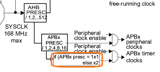

i used timer2 and it's clock source from  APB1   and Prescaler  value for  APB1 is 4
it's mean's APB1 work at 42mhz     ''168mhz/4 ''     becuase the maximum  frequency is 42mhz for APB1.
i searched in internet and some people write the timer2 clocked at 84mhz  not 42mhz and it's true.
but i cant find in this stm32f4 datasheet

Yes, review the clock tree in the Reference Manual. For DIV2 on the APB it is DIV1 on the TIMCLK, for DIV4 on APB it is DIV2 on the TIMCLK
