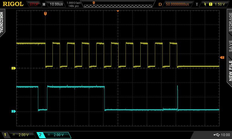

Hi All,
I am having an issue with I2C transmission on the STM32F4. After successfully transmitting an address byte with values of 0xE.. , the ADDR bit (Address Transmission Complete) in the SR1 register is set.
However, this is not the case when transmitting address bytes starting with 0xF.. (e.g. 0xF0, 0xF2, 0xF4 - corresponding to I2C device addresses 0x78, 0x79, 0x80) - the ADDR bit does not get set, despite the slave acknowledging the I2C transaction.
Here are the specifics of the system under test ...
A scope shot and a code snippet of the transmit routine can be found below.
Note the invalid logic level after the ACK bit (Bus Master i.e. STM32F4 pulls the line low after a short line-idle spike).
To rule out pull-up issues or latch-up, I have attempted: (a) Pulling-up the lines to +3.3V from the STM32F4DISCOVERY, (b) Pulling-up the lines to the clean +5V rail that is powering the SRF08, (c) Using a proper level converter for I2C lines (i.e. Texas Instruments' PCA9306). There is no change in the symptoms observed.
Has anyone encountered such an issue, and how do I go about resolving it?

Posted on October 31, 2013 at 14:05
the Slave Address is your the Problem. The valid Address Range for 8-Bit is from 0x08 to 0x77. The Range from 0x78 to 0x7f is reserved. The STM32 recongnize your Address automatical as 10-Bit Address. From there it will send in the next Byte the following 8-Bit from the Address (2-Bit are in the first Byte). I thing between this to Bytes the Master does not expect the Aknowledge from the Slave, therefore the internal State Machine from the I2C Master in the STM32 hangs-up.
