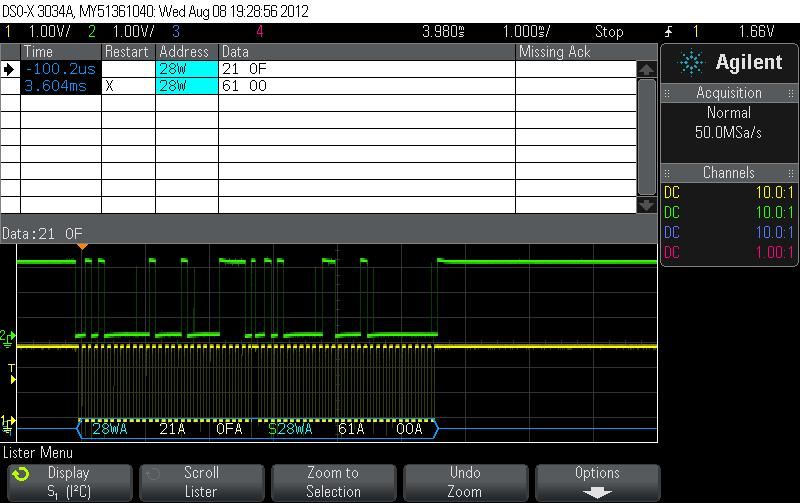

markgilson9
Posted on August 08, 2012 at 13:34
I still believe I am having issues with the I2C, specifically with the start and stop sequences.  Below is a screenshot of what I'm seeing.  The I2C address and data are definitely being acked, but Even though I have:
I2C_GenerateSTART(I2C, ENABLE);
I2C_GenerateSTOP(I2C, ENABLE);
It doesn't seem like I'm seeing the start or stop.  As you can see there is a restart event between my messages, implying no stop.
Any suggestions???
markgilson9
Posted on August 08, 2012 at 17:51
Actually, it appears the start is working, just not the stop.  Here's what I'm doing for my stop:
I2C_GenerateSTOP(I2C, DISABLE);
I2C_ClearFlag(I2C, I2C_FLAG_STOPF);
/* Send STOP condition */
while(I2C_GetFlagStatus(I2C, I2C_FLAG_STOPF)); // stop bit flag
