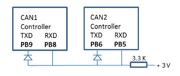

Thanks for your help. I want to connect two STM32F407 discovery board CAN pins together. So, I have to enable the transmitter and receiver pins on them.
Could I connect CAN pins of these
boards
together directly?
Posted on June 11, 2014 at 12:54
boards
together directly?
No, I'm pretty sure you're going to need a transceiver at both ends, and create the bus properly.

Mark Edwards
Posted on June 12, 2014 at 01:24
This works for testing purposes.It's from the keil example code, that I found a lot easier to get working and understand. (use 1N4148 diodes)
