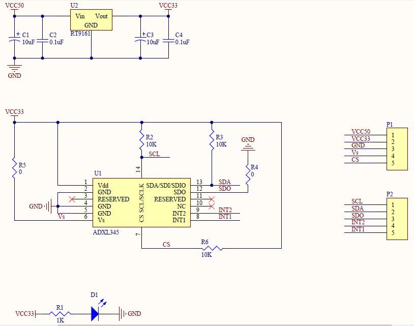

Posted on October 31, 2017 at 13:12
Ahh you're not using the same MEMS as me. I'm using the LIS3DSH. Google SPI modes, and have a look what mode matches your ADXL datasheet and set your CPOL and CPHA accordingly.
Also as you are using a different ic, you will probably have different register addresses.

I am using STM32f4 discovery board,actually .SPI is working I controlled with Osciloscope also NRF24L01 is working and I2C is working same ADXL345 I mean device is strong.Also my new codes are here.
