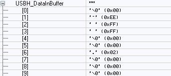

> Disk capacity : 3724541440 Bytes
In this case the usb-stick had 8Gb I have spent some time checking different posts i saw some posts with something similar for SD cards but I didnt find anything about USB sticks. Checking the code MSCapacity is set to uint32_t but it is sectors

Debugging the code here it is assigned but i'm reading the USBH_DataInBuffer
uint8_t USBH_MSC_ReadCapacity10(USB_OTG_CORE_HANDLE *pdev)
if(USBH_MSC_BOTXferParam.BOTXferStatus == USBH_MSC_OK)
/*assign the capacity*/
(((uint8_t*)&USBH_MSC_Param.MSCapacity )[3]) = USBH_DataInBuffer[0];
(((uint8_t*)&USBH_MSC_Param.MSCapacity )[2]) = USBH_DataInBuffer[1];
(((uint8_t*)&USBH_MSC_Param.MSCapacity )[1]) = USBH_DataInBuffer[2];
(((uint8_t*)&USBH_MSC_Param.MSCapacity )[0]) = USBH_DataInBuffer[3];
/*assign the page length*/
(((uint8_t*)&USBH_MSC_Param.MSPageLength )[1]) = USBH_DataInBuffer[6];
(((uint8_t*)&USBH_MSC_Param.MSPageLength )[0]) = USBH_DataInBuffer[7];
/* Commands successfully sent and Response Received */
USBH_MSC_BOTXferParam.CmdStateMachine = CMD_SEND_STATE;
status = USBH_MSC_OK;
this is what i get om USBH_DataInBuffer 0690X000006039yQAA.jpg 15663103 sectors with 512 bytes each =7.46gb, thats right but i see it as 3724 because it is too big for 32bits addressing. Is there a fix for this limitation?, any tip?. would it work if i create a partition under 4gb? We need only 100mb of the usb space, but the problem is that customers can put any kind of usb-stick, it is not easy to find actually usb sticks under 4gb, and force them to create a partition under 4gb when they are normal users is not a nice thing. Thanks in advance

I have fixed the displaying of drive capacity with
DebugString(''> File System initialized.
Debugprintf(''> Disk : %u sectors
'', USBH_MSC_Param.MSCapacity);
Debugprintf(''> %d sector size
'', USBH_MSC_Param.MSPageLength);
Debugprintf(''> Total: %u Mb
'', USBH_MSC_Param.MSCapacity/1024*USBH_MSC_Param.MSPageLength);

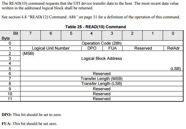

Checking this document (
http://www.usb.org/developers/docs/devclass_docs/usbmass-ufipdf
) from usb.org 4.7 READ(10) Command: 28h 0690X00000603A3QAI.jpg it is a 32 bits pointer... , limitation is in read10 command
/*logical block address*/
USBH_MSC_CBWData.field.CBWCB[2] = (((uint8_t*)&address)[3]);
USBH_MSC_CBWData.field.CBWCB[3] = (((uint8_t*)&address)[2]);
USBH_MSC_CBWData.field.CBWCB[4] = (((uint8_t*)&address)[1]);
USBH_MSC_CBWData.field.CBWCB[5] = (((uint8_t*)&address)[0]);
is there any implementation official or not of Write12/Read12 already? Thanks in advance.
Posted on July 18, 2016 at 15:12
READ(10)/WRITE(10) have a 32-bit *BLOCK* address, this equates to 2TB
The problem in most ST code is the use of 32-bit *BYTE* addressing, and the unnecessary conversion back-and-forth between BYTE and BLOCK numbers related to BLOCK storage media.
