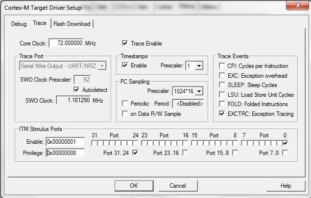

I have been trying recently to setup properly the debuging platform and it goes fine except for one thing. I can flash debug put breakpoints etc .. but I cannnot have printf come to the debug printf window in Keil.
I have checked all the tutorials and documentations that I have found, browsed many forums without being able to find a proper solution.
So I will sum up here what I have done. If any of you can figure out what I did wrong that would be great :)

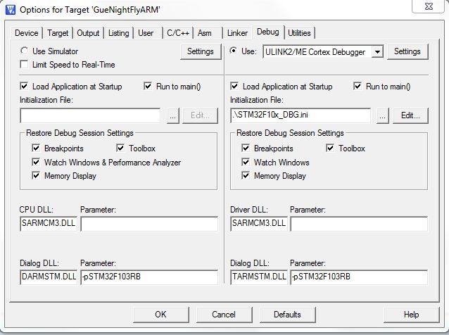

First of all debugging window :
Added to this configuration I have inserted the redirection of fputc :

} Finally after checking many samples and the documentation, I have made an .ini File (see above) which is used at debug startup :

Now when I use printf in my software, it will pass on the instruction and get into putc function, but nothing will come out on the debug printf in Keil.
If anyone has an idea of what could cause this, that would be VERY appreciated :)
