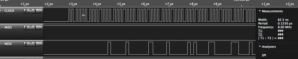

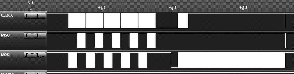

Logic Analyzer at 16 MHz ...
‎2014-05-14 1:30 PM
If anybody is interested to the solution - it is quite simple: Wait for the damn transfer to finish before writing to the buffers again.

At SPI_Prescaler_8 this results in 1 wrong byte in the last four chips.
Setting prescaler to 4 leads to this:
Starting program.
RAM chip 0 is OK!
RAM chip 1 is OK!
RAM chip 2 is OK!
RAM chip 3 is OK!
RAM chip 4 is OK!
