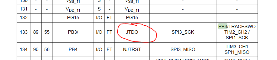

Hi All.
On my latest project I am using STM32F100VCT6 and PB3.  I am using this Pin as a quadrature encoder input for Timer 2 combined with PA15.  I can not get the encoder to work.  I tried setting PB3 up as an interrupt and it does not work, but PA15 does, I then tried setting PB3 as a GPIO and it does not work and PA15 does?????  I thought the CPU was faulty so swapped it and still noting from PB3.  The input signal is 5V peak to peak, but the datasheet states that pin is 5 Volt tolerant .

    the default state of PB3  after reset is as JTDO.
    So you need to remap it to PB3

    Enable the AFIO clock, and then free up the debugger pins
    RCC_APB2PeriphClockCmd(RCC_APB2Periph_AFIO, ENABLE);
    GPIO_PinRemapConfig(GPIO_Remap_SWJ_Disable, ENABLE);
    or
    GPIO_PinRemapConfig(GPIO_Remap_SWJ_JTAGDisable, ENABLE);

    I used the Cube to configure the 'PINS'.  SYS is set to 'NO DEBUG' so I assumed it would handle things like setting the functions to alternatives and disabling the JTAG.
    I think this should be included in the cube or a commented warning that it needs to be handled inserted in the USER SysInit section.  It would have saved me an others a few days scratching our heads.
    In the end I disabled SW and JTAG (*WARNING*) only do this if you have reset brought out to your programming header.
    SET_BIT(AFIO->MAPR, AFIO_MAPR_SWJ_CFG_DISABLE);
    Now PB3 is now working thank you very much....
