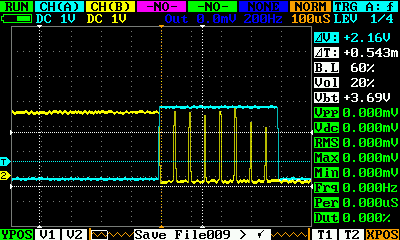

I'm hammering my table with my head the whole evening. I can't get the simpliest thing to work. Ok, here's the problem: I need TIM1 to gate TIM3. I've got TIM1 configured as a single-shot master with either TIM_TRGOSource_Enable orTIM_TRGOSource_OC1Ref signal sent to slaves. Then I have TIM3 set as a slave PWM generator. I want TIM3 to immidiately start firing pulses. Pictures will tell the better story:
0690X00000602PbQAI.bmp The blue waveform is TIM1, yellow is TIM3. Notice that TIM3 is now acting withTIM_OCPolarity_High and in PWM1 mode. _
Absolutely the same picture

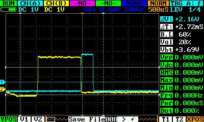

_ is whenTIM_OCPolarity_Low and PWM2 mode. And this is crazy, because notice that yellow is HIGH _before_ the gate comes to the scene. The same picture with different scale: 0690X00000602PgQAI.bmp TIM3_CH1 goes high immediately after callingTIM_OC1Init(TIM3, &TIM_OCInitStructure); It is the combination of polarity and PWM mode that defines if the output will be HIGH or LOW. Timer have not even started counting, and the output goes high. I believe this is a very bad bug here.Any comments/advices?
