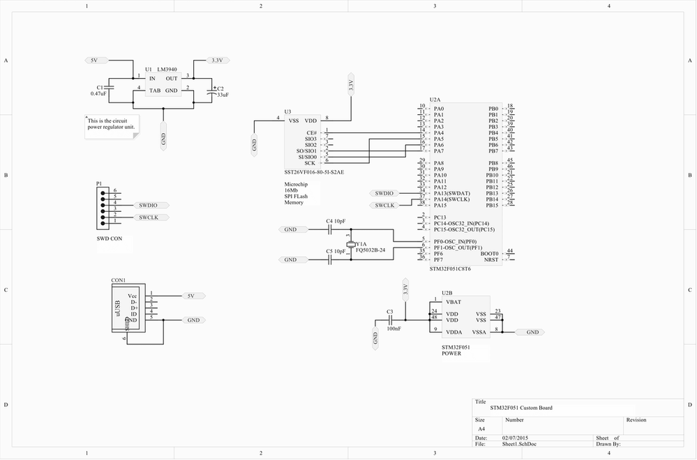

Hello there, thank you for taking a look at my discussion , I designed the following custom STM32F051 board circuit and before sending it for manufacture I thought like posting it here to verify if everything will work.
Here is a schematic: (I also attached the pdf for more bigger size)
As you can see the circuit is relatively simple, with a voltage regulator, the stm32f051 chip and a spi 16Mb flash memory.
Please let me know if I made any mistakes or is it good to go.
Thank you !!

Posted on July 02, 2015 at 15:33
I'd get NRST and GND to the SWD Header
I'd have a pull up on NRST
I'd have a pull down on BOOT0, or ideally a way to select it high/low
I'd provide a means to connect as serial header to USART1 PA9/PA10
I'd probably consider adding pads for series/parallel resistance to the oscillator unless I'd prototyped specific components without them.
Assuming you're just using USB for power

Posted on July 05, 2015 at 16:22
If you are still going with your own board, review Section 6.1.6 in the data sheet for the recommended Vdd and Vdda capacitors to ground.
