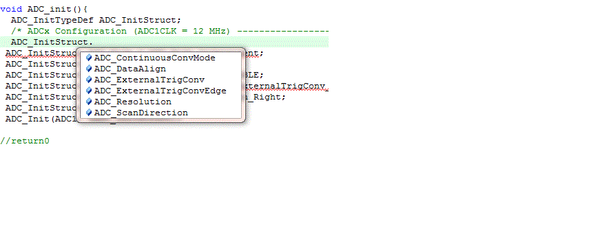

Dear All,
I started STM32F0 ADC configurations
select independent conversion mode (single)
ADC_InitStructure.ADC_Mode = ADC_Mode_Independent;
But my CMSIS stm32f0xx.adc.c file does not have above ADC.Mode command and also it does not have
0690X0000060MmzQAE.gif Please advice

Posted on December 26, 2014 at 09:06
Ok, but please provide some actual context here about what you're attempting to do, and where you pulled the independent stuff from in the first place. Cite sources.
