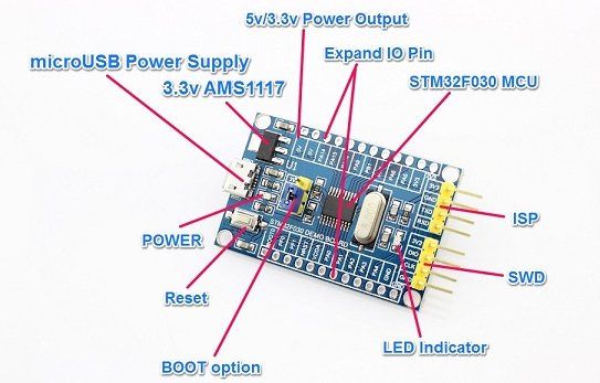

I have just got a new board that I purchased using the STM32F030F4P6 MCU.
This is a Mini Developing board that you can get from Ali Express and it is good as well IMHO.
The Board that I have is:
And I am bit struggling to make it to work under Arduino IDE or any other Software.
I am NEW to STM32 boards and I am willing to learn as much as its needed in order to upgrade my IoT MCU to a better solution in my projects.
I would be happy to know - How do I connect this board to the PC - using STLInk V2? to the Rx and Tx? I have tried connecting the power to the on board micro USB BUT no port was added.
I would be happy if someone can help me start with STM32 and also assist me with this new board I got to make it work.

There is some info on running your F030F4P6 board with arduino IDE here:
https://github.com/BLavery/STM32F030F4P6-Arduino
It uses STlink to program, but you might need to use further references re installing STlink for your PC.

There is a free license version of Keil for ST CM0 processors.
The external ST-LINK would connect to the SWD connector here, the debug signals primarily being SWCLK and SWDIO
With the BOOT option high I'd expect you can use the RX/TX with the STM32 Cube Programmer software in USART mode.
USB likely needs software on-board to work.
A schematic would be helpful, and you should review the part Data Sheet and Reference Manual.

I would take a Nucleo/Discovery schematic as template for the SWD connection. These board have internal ST-Link.
That would require an adequate firmware to happen.
On the Nucleos, this is the functionality of the ST-Link part, with appropriate drivers on the host. And the UART connection to the target, too.
No Arduino user. Doesn't it require a specific loader app on the target board ?
The title mentioned Atmel Studio. IMHO neither a good approach, this toolchain is quite a bit Atmel/Microchip - centric.
As the previous poster suggested, try Keil with it's free CM0 license.

‎2018-11-08 2:00 AM
Thanks, Just realized that it is updated from Yesterday! that is good NEWS =)
Just wanted to add that it is So simple now to upload sketches for this board - the instructions are straight forward and Works!!!!!
