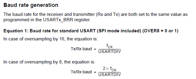

From STM32F0xx_hal_uart.h
/** @brief BRR division operation to set BRR register in 8-bit oversampling mode.
* @param __PCLK__: UART clock.
* @param __BAUD__: Baud rate set by the user.
* @retval Division result
&sharpdefine UART_DIV_SAMPLING8(__PCLK__, __BAUD__) ((((__PCLK__)*2U) + ((__BAUD__)/2U)) / (__BAUD__))
/** @brief BRR division operation to set BRR register in 16-bit oversampling mode.
&sharpdefine UART_DIV_SAMPLING16(__PCLK__, __BAUD__) (((__PCLK__) + ((__BAUD__)/2U)) / (__BAUD__))0690X000006073zQAA.png
So why is there a (__BAUD__)/2U) term in equations?
#baud-rate #stm32f0
1 REPLY 1
Posted on May 21, 2017 at 03:31
Think of it as adding 0.5 after the division, ie rounding up
