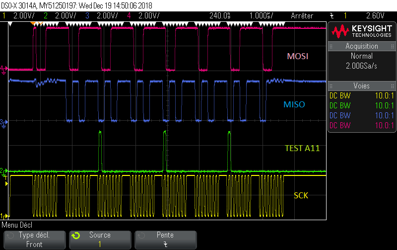

    Mich1
    Mich1Author
    December 19, 2018
    I modify the code as following:
    char spi_read_reg_spi2_withadr(unsigned char adr)
    	uint8_t tmp3[16];
     uint32_t n = 0, i = 0;
     for (i=0; i < 8; i++)
     /* Check TXE flag to transmit data */
     while ( !LL_SPI_IsActiveFlag_TXE(SPI2));
     while (LL_SPI_IsActiveFlag_BSY(SPI2)); // wait while busy,
     /* Transmit 8bit Data */
     LL_GPIO_SetOutputPin(TESTA11_GPIO_Port, TESTA11_Pin);
     LL_SPI_TransmitData8(SPI2, adr);
     LL_GPIO_ResetOutputPin(TESTA11_GPIO_Port, TESTA11_Pin);
     /* Check RXE flag */
     if(LL_SPI_IsActiveFlag_RXNE(SPI2))
     /* Receive 8bit Data */
     tmp3[n++] = LL_SPI_ReceiveData8(SPI2);
     return (tmp3[0]);
    and I can see that the RXNE flag is set only after the 3rd TX:
    Why must I send 3 bytes before having 1 RX when the SPI is configured as 8 bit data width?
    Mich1
    Mich1Author
    December 20, 2018
    issue was linked to the FIFO Threshold. It is ok now.
