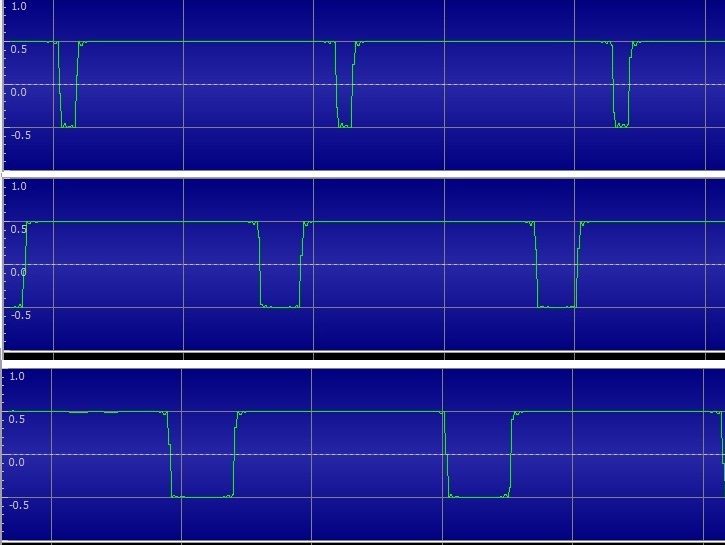

my servo need a square signals with 20ms, I have tried a timer with interrupt but does can run
this my program:

Posted on October 13, 2011 at 18:27
Presumably not truly square (50/50) because you need to pull the duty in/out to achieve the ''angle'' you want. What's the specification for that? ie min/max high time.
PC.7 is being driven by the TIM3_CH2 output, you don't control it by writing to the GPIO pin directly.
The values for scale and period are nonsensical, it will generate a ~95Hz signal (10.525 ms) on the pin, and call your update interrupt at that periodicity.
Whereas
scale = 48; // Assuming a 24 MHz TIMCLK, gives 500 KHz timebase
period = 10000;
Would give you 50 Hz (20 ms period), and provide a duty cycle sweepable from 0 to 100% in 0.01% increments (2 us tick units), which you could program in interrupt using the TIM3 CCR2 register (with 0 .. 10000). Your timer interrupt will also need to actually clear the source of the interrupt, otherwise it will continually tail chain.

Ok, I don't see a horizontal scale, but I'll assume you have a 20 ms period.
With PWM you control the ''width'' of the high portion with the CCR register for the channel. It's referred to as the duty cycle, 10/90 would spend 2 ms high, 18 ms low, using my suggested settings you'd be programming in 1000 into the CCR
Again, what is the minimum and maximum width of the high portion? I don't have the specifications for *your* servo.
With that information you could convert a fractional angle, 0-360 degrees, into a setting written into the CCR.
Some typical ones rotate 180 degrees and expect a 600 to 2400 us width to achieve that range, ie 1800 us or 900 tick units at 500 KHz (2 us)
TIM3->CCR2 = 300 + (u16)(angle * 10.0); // where angle is a float 0.0-180.0 degrees

Your AVR code manually drives the pin, the STM32 timers are capable of generating the signal directly. You set up the timers, then you program a register with a value based on the angle you want the servo to attain.
Here's a specification for the signalling.
http://www.servocity.com/html/hs-325hb_bb_deluxe.html
