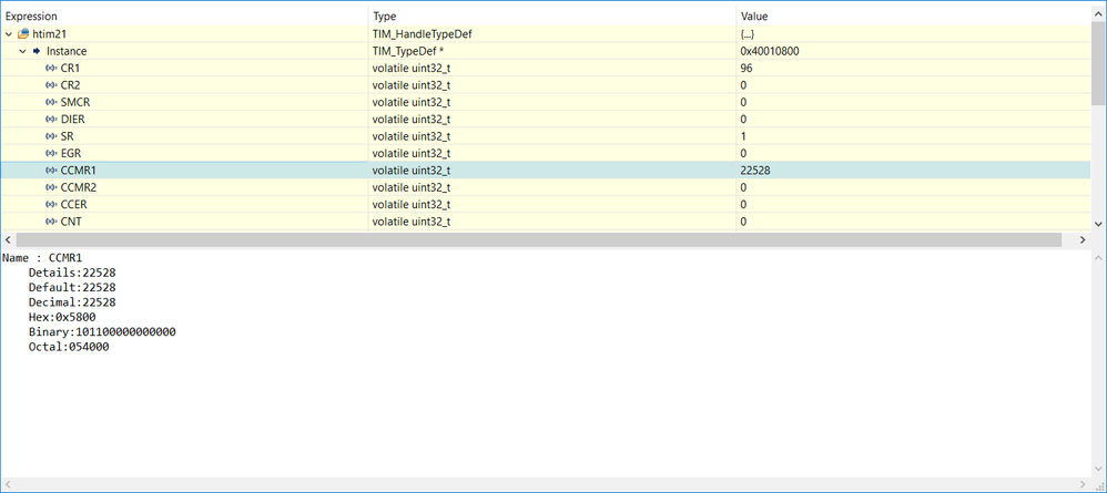

The effect is that if i measure with the oscilloscope the PWM output, is not forced to HIGH.
Pablito Parseval
Posted on February 15, 2018 at 13:19
Like you can see in the image below, the CCMR1 register have the bit [14:12] set to 101 like required
in the datasheet.
Posted on February 15, 2018 at 13:08
What's the content of TIM21 registers (after the 'forcing' routine)?
Read them out in debugger and post.
Posted on February 15, 2018 at 14:30
Yes indeed, but also CCER is all zero which means the CCxE bits are cleared.
Try to set them.
