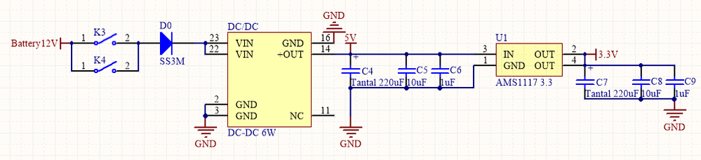

Hello
Our team is using STM32F103R8T6 and STM32F405R8T6 for a robot and for some reason sometimes when we turn the power on (from battery or a DC power Supply) the MCUs short from the inside and when we change the header board for the MCUs which we designed ourselves, everything is fine.
we have also used coupling capacitors as recommended in STM32 datasheets.
What do you suggest? is there anything we have missed?
if anymore information is needed, i'd be happy to provide.

Don't know how you connected all the needed Stuff (Power-Pins of MCU with some 10nF and 100nF Capacitors, nReset-Pin). But you should look with an Oscilloscope on these Pins. Is your Power-Supply stable? Is the Reset-Pin fine?

Unfortunately you need to take a more systemic view, large voltages/currents can be introduced through a variety of routes, and back into the supplies. Review the whole design looking for potential to violate the 'absolute maximum' limits on all pins, especially those controlling motors, relays, etc where large reverse emf pulses might occur, or large voltage/current spikes.
Consider if you need more protection on IO pins.
Posted on March 15, 2017 at 16:23
I'd agree with this assessment.
Either you violate some power supply related requirements (perhaps temporarily injecting voltages on GPIOs before Vcc is stable), or you have EMI issues with attached inductive components.

I think you are getting ground spikes when the switch is bouncing.
i try to use inrush current protection into a larger capacitance, I dont have any trouble.
eg, after the switch before the 5V switcher
but you may feel this is going overboard.

thank you I think this may be it we are monitoring all the voltages to see what's what
