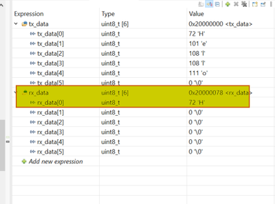

I want to send a simple message through UART and check if message is properly received at Rx end. I want to do loopback test. I connect PD5 to PD6, namely short circuit. Then I run the below code. When I debug the code, I can see only the first byte is received. I tried many ways to fix it but cant find out the root cause, eventually cant resolve the issue.
I am looking forward to hearing some help. Thank you.

KnarfB
HAL_UART_Transmit is a blocking function, it returns only after the entire message was sent.
Then, HAL_Delay(1000); waits for another second.
Then, after all, you start receiving chars with HAL_UART_Receive.
Where do you expect the message to sit and wait meanwhile?
Your approach is inherently broken.
Look for USART examples that come with HAL STM32CubeF4/Projects at master · STMicroelectronics/STM32CubeF4,
or Getting started with UART - stm32mcu
Try communicating with a second board/host PC, or using interrupt / DMA.
hth

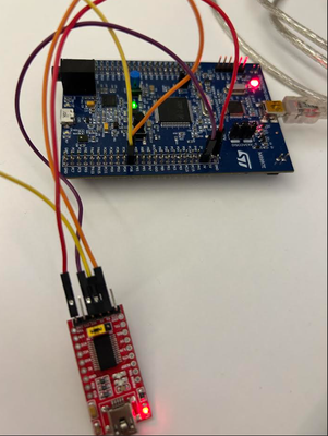

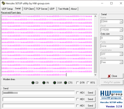

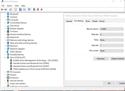

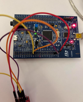

Allright, I tried to send data to my PC using FT232RL. Please see my connection at below image.
I have also edited the code please see below.
I have opened port COM4 through HERCULES (a program to monitor serial port).
I still CAN NOT see the message sent to PC on Hercules even I see that green LED blinks which is an indication that message is transmitted.
However, even I keep sending bytes to PC via hercules, I can not receive it as I see the RED led blinks.
My port settings are as below.
I am veryyyyy confused and would be glad if you could support.
Thanks.

Yeah, out of focus pictures aren't super helpful. Perhaps you can enumerate actual connectivity?
PD5/PD6
PD5 (USART2.TX AF7) would presumably need to go to the FTDI RX. Perhaps get a scope or logic probe on the signal.
Do you get successful reception of data on the PC? Start with that as Step#1
Blocking and dwelling for 5 seconds to get input on the STM32 probably not ideal. Perhaps use the IT versions so you can get concurrent reception.
