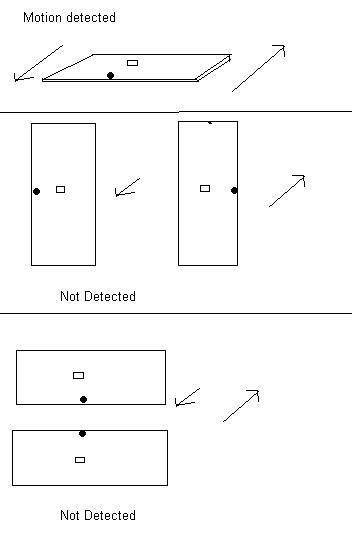

    I am getting these interrupt on INT2 and not INT1 pin , i can see the interrupts  coming on INT1  in scope , but they dont generate a GPIO inerrupt on  MC ,perhaps some problem with board ,  but when INT2 is enabled ( 0x40h in CTRL_REG6  of Accelerometer)   i will get same signal on INT2 and  INT1 perhaps same signal is duplicated on INT2 and i get this on GPIO interrupts ,
    so far its detecting motion only when the  PCB board is  oriented in a position parallel to earths surface , but when it is kept vertical and moved along x or y axis no interrupts are generated .
    I have tried enabling  6D etc while the Datasheet says that  ''AOI-6D = ?01? is movement recognition. An interrupt is generate when orientation move from
    unknown zone to known zone.''  But  Its only Orientation Detection , and not Motion Detection
    Also i have tried different combination on XYZ higl low enable bits in INT1_CFG but nothing seems to work for  motion detection when orientation is vertical
