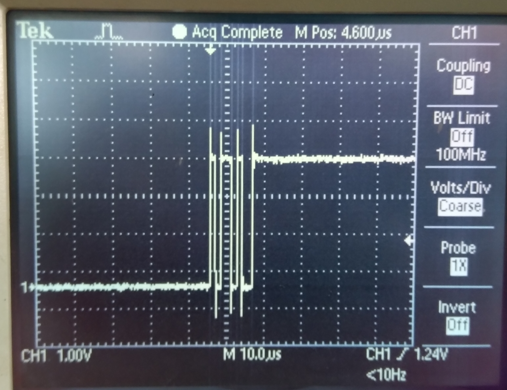

i am trying to interfacing tsc2046 with stm32 using SPI communication, when i used NSS hardware at that time MOSI line continuously high & signal getting busy & code stuck.(when i used NSS software its working ok)

//SPI CONFIGURATION
void TSC2046Config(void)//16.3.2022
GPIO_InitTypeDef GPIO_InitStructure;
 EXTI_InitTypeDef EXTI_InitStruct; //11.2.2020
 SPI_InitTypeDef SPI_InitStruct;
 NVIC_InitTypeDef NVIC_InitStructure;
 DMA_InitTypeDef DMA_InitStructure;                      //13.1.2020
 GPIO_InitStructure.GPIO_Pin  = GPIO_Pin_8;//16.3.2022 PENIRQ
 GPIO_InitStructure.GPIO_OType = GPIO_OType_PP;
 GPIO_InitStructure.GPIO_PuPd = GPIO_PuPd_UP;
 GPIO_InitStructure.GPIO_Mode = GPIO_Mode_IN;
 GPIO_InitStructure.GPIO_Speed = GPIO_Speed_50MHz;
 GPIO_Init(GPIOB, &GPIO_InitStructure);
 SYSCFG_EXTILineConfig(EXTI_PortSourceGPIOB, EXTI_PinSource8);
 EXTI_InitStruct.EXTI_Line = EXTI_Line8;
 EXTI_InitStruct.EXTI_LineCmd = ENABLE;
 EXTI_InitStruct.EXTI_Mode = EXTI_Mode_Interrupt;
 EXTI_InitStruct.EXTI_Trigger = EXTI_Trigger_Falling;
 EXTI_Init(&EXTI_InitStruct);
 GPIO_InitStructure.GPIO_Pin = GPIO_Pin_3;// SPI2 SCK ;
 GPIO_InitStructure.GPIO_Mode = GPIO_Mode_AF;
 GPIO_InitStructure.GPIO_PuPd = GPIO_PuPd_NOPULL;
 GPIO_Init(GPIOD, &GPIO_InitStructure);
 GPIO_PinAFConfig(GPIOD, GPIO_PinSource3, GPIO_AF_SPI2);
 GPIO_InitStructure.GPIO_Pin = GPIO_Pin_3;//SPI2MOSI;
 GPIO_InitStructure.GPIO_PuPd = GPIO_PuPd_DOWN;//GPIO_PuPd_NOPULL;
 GPIO_Init(GPIOI, &GPIO_InitStructure);
 GPIO_PinAFConfig(GPIOI, GPIO_PinSource3, GPIO_AF_SPI2);
 GPIO_InitStructure.GPIO_Pin = GPIO_Pin_2;// SPI2 MISO;
 GPIO_Init(GPIOC, &GPIO_InitStructure);
 GPIO_PinAFConfig(GPIOC, GPIO_PinSource2, GPIO_AF_SPI2);
 GPIO_InitStructure.GPIO_Pin = GPIO_Pin_5;  //SPI2 Slave select
 GPIO_InitStructure.GPIO_Mode = GPIO_Mode_OUT;
 //GPIO_InitStructure.GPIO_OType = GPIO_OType_OD;
 GPIO_Init(GPIOH, &GPIO_InitStructure);
 GPIO_SetBits(GPIOH, GPIO_Pin_5);
 // enable peripheral clock
 RCC_APB1PeriphClockCmd(RCC_APB1Periph_SPI2, ENABLE);
 SPI_InitStruct.SPI_Direction = SPI_Direction_2Lines_FullDuplex; // set to full duplex mode, seperate MOSI and MISO lines
 SPI_InitStruct.SPI_Mode = SPI_Mode_Master; // transmit in master mode, NSS pin has to be always high
 SPI_InitStruct.SPI_DataSize = SPI_DataSize_8b; // one packet of data is 8 bits wide
 SPI_InitStruct.SPI_CPOL = SPI_CPOL_Low; // clock is low when idle
 SPI_InitStruct.SPI_CPHA = SPI_CPHA_1Edge;//SPI_CPHA_2Edge; // data sampled at first edge
 SPI_InitStruct.SPI_NSS = SPI_NSS_Hard;//SPI_NSS_Soft | SPI_NSSInternalSoft_Set; // set the NSS management to internal and pull internal NSS high
 SPI_InitStruct.SPI_BaudRatePrescaler = SPI_BaudRatePrescaler_64;
 SPI_InitStruct.SPI_FirstBit = SPI_FirstBit_MSB;// data is transmitted MSB first
// SPI_InitStruct.SPI_CRCPolynomial = 7; //19.12.2019
 SPI_DataSizeConfig(SPI2,SPI_DataSize_8b);//20.12.2019
 SPI_Init(SPI2, &SPI_InitStruct);
 SPI_Cmd(SPI2, ENABLE); // enable SPI3//19.12.2019
NVIC_InitStructure.NVIC_IRQChannel = EXTI9_5_IRQn;     //16.3.2022
 NVIC_InitStructure.NVIC_IRQChannelPreemptionPriority = 2;
 NVIC_InitStructure.NVIC_IRQChannelSubPriority = 2;
 NVIC_InitStructure.NVIC_IRQChannelCmd = ENABLE;
 NVIC_Init(&NVIC_InitStructure);
uint16_t TSC2046_SendCommand(uint8_t cmd)
uint8_t spiBuf[3] = {0,0,0};
uint16_t return16=0;
int i=0;
_TS_CS_ENBALE;
spiBuf[0] = cmd;
     while(!SPI_I2S_GetFlagStatus(SPI2, SPI_I2S_FLAG_TXE));
      SPI_I2S_SendData(SPI2,spiBuf[0]);
    for(i=0 ;i<2;i++)
     // while(!SPI_I2S_GetFlagStatus(SPI2, SPI_I2S_FLAG_RXNE));
      spiBuf[i+1] = SPI_I2S_ReceiveData(SPI2);
    //return16 = (spiBuf[1]<<4) + (spiBuf[2]>>4);
    return16 = (spiBuf[1]<<4);
_TS_CS_DISABLE;
return return16;
uint16_t TSC2046_getRaw_Z(void)
return TSC2046_SendCommand(CMD_Z_AXIS | CMD_Default);
uint16_t TSC2046_getRaw_X(void)
return TSC2046_SendCommand(CMD_X_AXIS | CMD_Default);
//ii. get y-axis raw touch 12-bit value
uint16_t TSC2046_getRaw_Y(void)
return TSC2046_SendCommand(CMD_Y_AXIS | CMD_Default);
void main()
if(TouchDetected)
   TouchDetected =0;
   Touchz = TSC2046_getRaw_Z(); //MOSI line is low but after transmitting data its high
   Touchx = TSC2046_getRaw_X(); //code stuck here bcz signal is continuously busy
   Touchy = TSC2046_getRaw_Y();

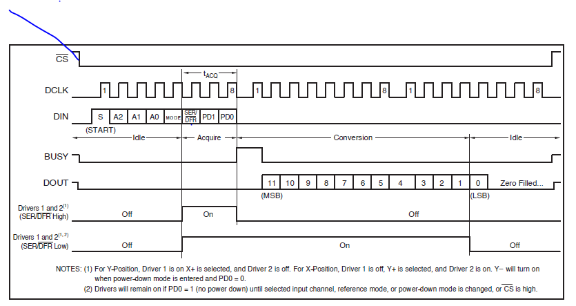

NBava.1
in above image after transmitting data, DIN pin is low but in my case idle condition is low but after data transmission its show high
NBava.1
sir i am using HAL library its successfully work but when i trying without HAL library its not work. i was already share you the details , MOSI pin waveform & code flow.
