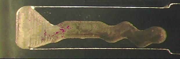

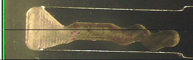

thanks alot fm for your suggestion. I found a new way for VGA format. I captured two pictures from camera without FIFO. After i combined this pictures as follow.
But, there are a problem. i dont removed black line in the middle of the Picture.
Black end White is a good idea. But as far as I know, camera does not support grayscale.
it supports just; YUV, RGB and RAW.
frankmeyer9
Posted on September 26, 2013 at 16:50
From my (rather feeble) knowledge of your project/code, it could well be a bug in how you 'stitch' the parts of the image together.
You can do a ''BW_Intensity = (Red + Green + Blue) / 3'' for each pixel on the fly, before storing it to the RAM buffer. As dave suggested, that would reduce your RAM footprint significantly - if you can live with BW pictures.

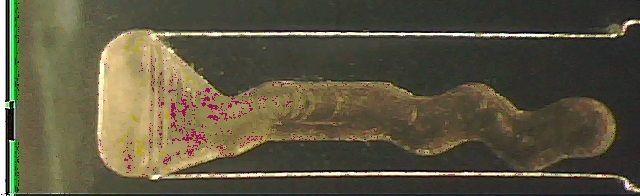

yesil_kaya76
Posted on September 30, 2013 at 17:13
Thanks a lot fm for everythings.
 My black line problem in the middle of the Picture is solved with your suggestion.
Now, only there is a problem. there are a lot
pink
blot in the my picture. How can I solve this problem.
Posted on September 30, 2013 at 17:45
The green stuff at the edge suggests you don't have the framing/timing right. Front/Back porch?
The pink stuff is more indicative that the colour bit assignments are wrong or misaligned bit stream. ie an issue extracting/decoding the RGB or YUV

yesil_kaya76
Posted on October 01, 2013 at 12:52

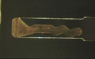

I solved the green stuff at the edge.
there are not pink stuff at the Picture when Picture was QVGA (320*240).
But, there are pink stuff at the Picture when Picture was VGA (640*480).
As follow :
