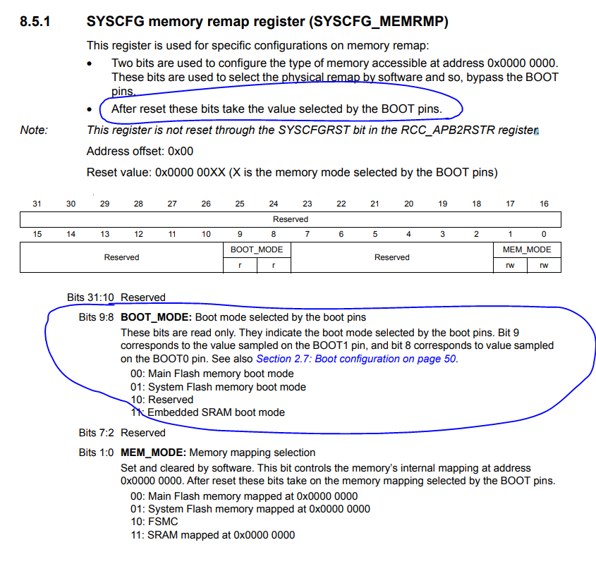

I would like to be able to read the BOOT0 pin level at boot.
I tried the following. It reads the BOOT_MODE from the SYSCFG register:
// Turn on blue LED if BOOT0 is low at boot
if (__HAL_SYSCFG_GET_BOOT_MODE() == SYSCFG_BOOT_MAINFLASH)
  // BOOT0 pin is low (turn off the blue LED)
  HAL_GPIO_WritePin(BLUE_LED_GPIO_Port, BLUE_LED_Pin, GPIO_PIN_RESET);
else
  // BOOT0 pin is high (turn on the blue LED)
  HAL_GPIO_WritePin(BLUE_LED_GPIO_Port, BLUE_LED_Pin, GPIO_PIN_SET);
Then I activated protection level 2, and pulled BOOT0 high. But It does not turn on the blue LED. I tried the blue LED before so I know it worked.
I thought the MCU samples the BOOT0 pin at startup even if protection level 2 is enabled, or am I wrong?
I also tried (on another board) the following to send the hex values from SYSCFG->MEMRMP and FLASH->OBR on the serial port.
uint32_t regValue = SYSCFG->MEMRMP;
sprintf(outString, "SYSCFG->MEMRMP = 0x%08" PRIX32 "\r\n", regValue);
sendString(outString);
regValue = FLASH->OBR;
sprintf(outString, "FLASH->OBR = 0x%08" PRIX32 "\r\n", regValue);
I got:
SYSCFG->MEMRMP = 0x00000000 <-- Does not indicate the BOOT pins!!!!!!
FLASH->OBR = 0x007800CC <-- CC = protection level 2
 The reference manual states that the SYSCFG_MEMRMP shall be updated after reset with the BOOT pins:0693W000007ZUz2QAG.png
Is SYSCFGEN bit enabled(clock enable for syscfg) before try to read MEMRMP register?
Pavel A.
Protection level 2 disables booting to the "system memory" bootloader.
So what you see can mean just this.
-- pa

But the reference manual says:
After reset these bits take the value selected by the BOOT pins.
If this is not so when protection level 2 is selected then ST should make a change to the reference manual.
