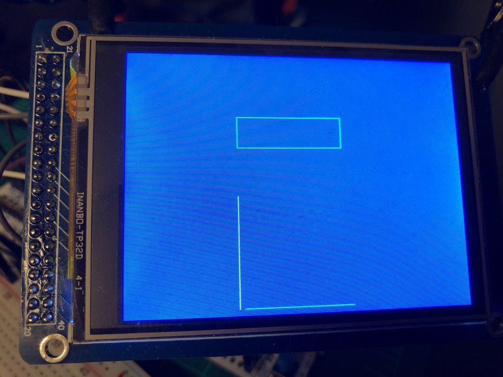

I have no difficulty operating the display so long as the BufferSize is < 22. When the BufferSize is 21 or less (I have tried 21, 20, 19, 18, 16, 15, 12, etc.) it works perfectly, and the TFT display shows exactly what I send to it. But when BufferSize is >= 22, everything goes wrong.
Here is an example of the TFT display, with a BufferSize less than 22. It includes:
  1. Fill screen blue
  2. Draw green rectangle
  3. Draw yellow vertical line
  4. Draw green horizontal line

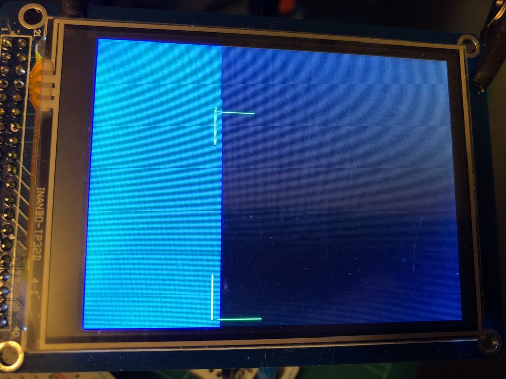

Now, here is the same example with the BufferSize greater than 21:
I should mention that right now I am not using interrupts to pace the Write_DMA calls. In case this was happening because my Writes were being sent before the last one finished, I put a HAL_Delay(100) between Writes and there was no change. So, that does not seem to be the problem.
