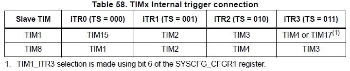

Check the Reference Manual for internal trigger mapping that would get a Master TIMx_CHx to fire a slave

I have also tried to trigger timer8 from timer2 channel 2 (capture compare) but are not able to do so.
It is easy to setup timer8 to trigger on the timer2 output. But I can only find settings to generate trigger signals from timer2 output compare. I need to trigger on input capture.

which chapter exactly is the ''internal trigger mapping'' ?

You can pick the trigger output on the master, and the source timer on the slave.
