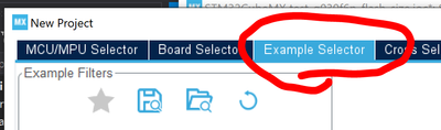

You can use the Example Selector within STM32CubeMX/STM32CubeIDE to load examples.
