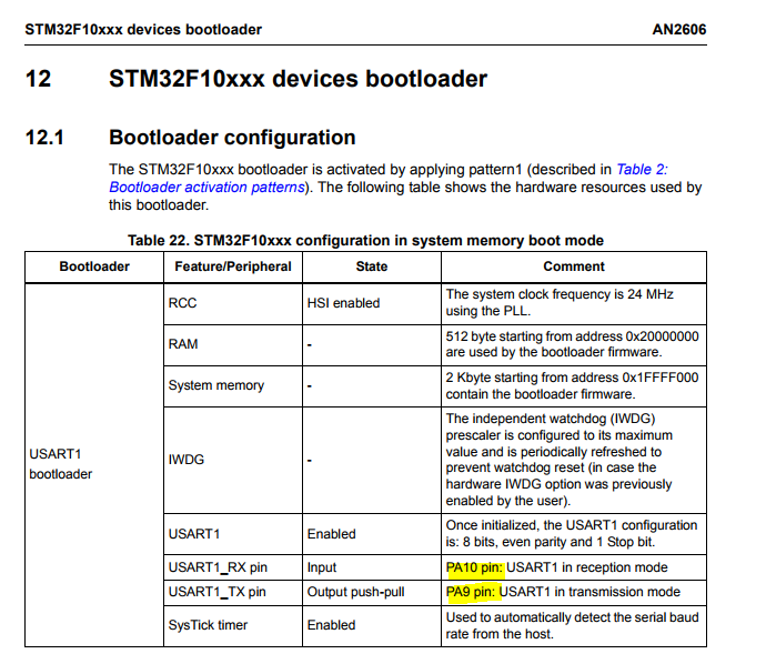

Currently i have project and i want to use flash loader to program the MCU(stm32f103rbt6), i can't use USART1 pins,is it possible to use USART2(PINA2, PINA3) for flash loader and connect this pins to usb2usart converter?

Posted on July 12, 2017 at 14:43
I read this application note, but it just said use USART1 in stm32f103,it does not mention wich pin's should be use?
pin (A9,A10) or (B6,B7)?

Posted on July 12, 2017 at 15:01
Hi
Sadati.Danesh
Please refer toTable STM32F10xxx configuration in system memory boot mode
