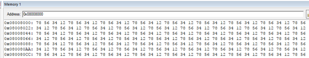

Hello I am looking at the STM32F429 Discovery board Flash memory sample source as below.
I'm recording Hex values in flash memory.
The sample is to be input with a value of 4 bytes Hex ((uint32_t) 0x12345678).
Tell me how to write text (hello world) and date (2017-11-09) to Flash memory
Thank you.
Have a nice day!!

<Memory
Debugging>

Posted on November 10, 2017 at 03:31
So use a uint32_t* pointer and advance it with each write
char str[] = 'Hello World!';
uint32_t *p = (
uint32_t *)str;
    if (HAL_FLASH_Program(FLASH_TYPEPROGRAM_WORD, Address, *p++) == HAL_OK)
      Address = Address + 4;

After writing text and date in flash memory
Lead Text and date, move to buffer or variable
I want to write to usb stick memory sequentially.
If you have a similar sample, I would appreciate your support.
Have a nice day!
Posted on November 10, 2017 at 05:15
Is the date format the same?
It is all just bytes of data in memory, the processor doesn't distinguish if it is a greeting or a time stamp. The routine you have writes 32-bit words, a collection of four 8-bit bytes.
Create and manipulate strings with strcpy(), strcat(), sprintf(), etc
char str[] = 'Backup generator failed to start 2017-11-09 09:32';
uint32_t *p = (uint32_t *)str;
uint32_t WordCount = (strlen(str) + 3) / 4; // 32-bit words in string
while (WordCount--)
else
/* Error occurred while writing data in Flash memory.
User can add here some code to deal with this error */
FLASH_ErrorTypeDef errorcode = HAL_FLASH_GetError();
Error_Handler();
