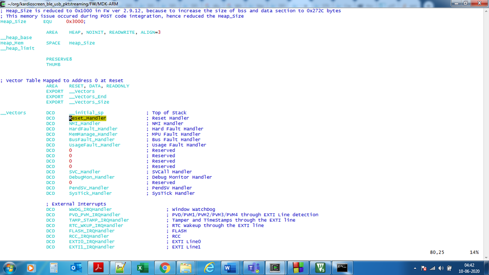

Hi clive 1
how to add _estack in vector table startup_stm32l476xx.s
i am using keil ide. i'm not aware of startup files and linker files. please can you help me out
Thanks,
Raghu.
__Vectors    DCD   0x20002000        ; Top of Stack
        DCD   Reset_Handler       ; Reset Handler
        DCD   NMI_Handler        ; NMI Handler
Reset_Handler  PROC
         EXPORT Reset_Handler       [WEAK]
    IMPORT SystemInit
    IMPORT __main
         LDR   SP, =__initial_sp
         LDR   R0, =SystemInit
         BLX   R0
         LDR   R0, =__main
         BX   R0
         ENDP
Hi Clive,
Thanks for quick response. now it's working
Thanks,
Raghu.
