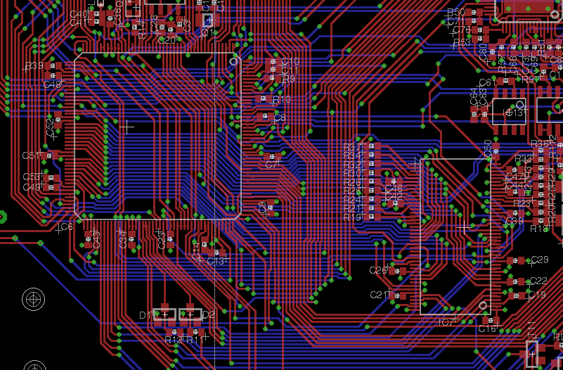

I have an STM32F746 in an own PCB design. A 128 Mb DRAM IS42S32400F is connected to the FMC pins, similar as on the STM32F746G-DISCO board. I can write and read data but there are errors which occur in a systematic way:
I start writing 16 bit data at address 0xC000 0000.
Data is stored at the the correct address. But, the strange thing is that the same data appears simultaneously at a second location either 32 byte above or below the intended address. How can this happen? How can data be stored at two locations with one write command?
A memory dump screenshot is attached.
I have double-checked all connections and fiddled with timing - but no success.
In my design I didn't care about matched trace lengths. Controller and SDRAM are about 4 cm apart. Could this be a reason?
I can also observe the same problem on an LCD sreen since the SDRAM is also my frame buffer.

‎2019-02-15 9:41 AM
One of the address pins is screwed up, ie stuck at one/zero, not connected, not configured, etc.
Turn off caching while testing.

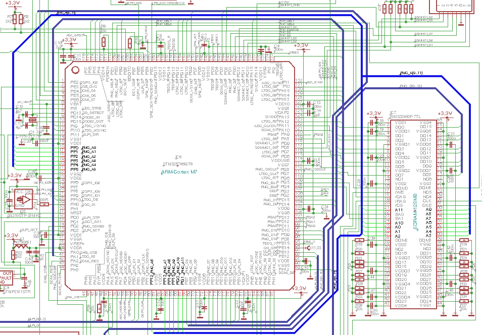

‎2019-02-18 7:26 AM
It is more probably read back wrongly.
Rather than hope someone turns up with the same chip and configuration, perhaps post the pin/peripheral initialization code, and circuit specifics, for review.
Presumably the DISCO works fine with equivalent configuration.

I have also attached the relevant parts of schematic and PCB.

‎2019-02-26 11:30 PM
Just to close this topic, I replaced the IS42S32400F by a MT48LC4M32B2P and everything works fine - without knowing why.
