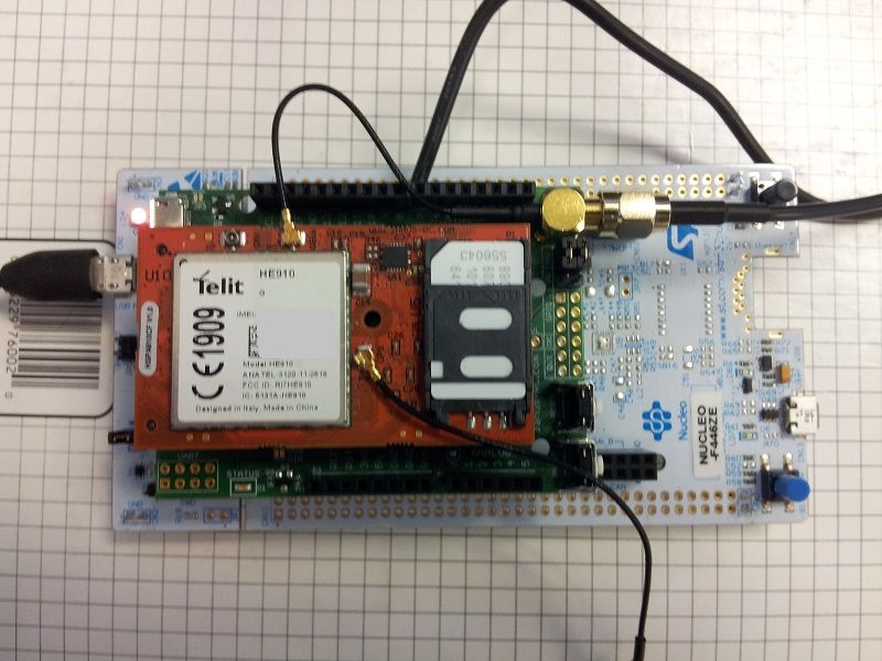

What I am trying is connecting to a external 3G-module for testing before initial board available.

This is exactly what I need to do.  I will be using the new ST SensorTile (STM32L4) and connect to Telt too.
Since HW not available at the moment, I am using the NUCLEO-F411 & SIMCOM to develop a Serial driver for UART port.
I finally able to communicate with Putty through USART1 (at 115200, 8-bit, no flow control).  Send & receive OK while receive running IRQ to put UART data into circular buffer.
