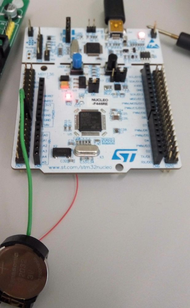

Posted on December 05, 2017 at 06:52
Sure!
I've done it many times on my F4 Nucleo boards.
Here my VBAT is Pin1!
