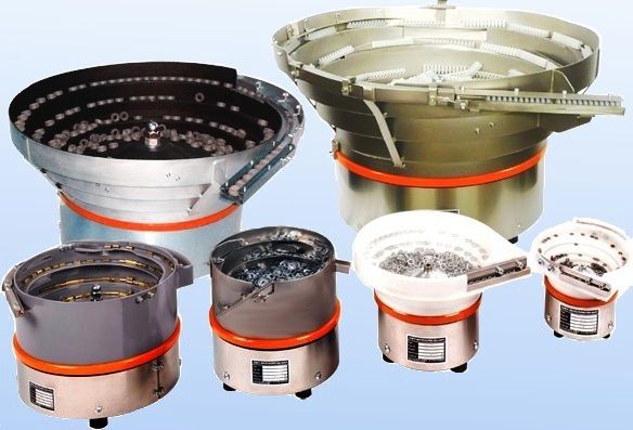

hello dear forum
I designed an inverter for vibration tank ( photo below ) it issimply an H bridge with 500 V 20 A mosfets the frequency and duty is variable with STM32F103 the vibrator worked for 5 minutes and one of the H-mosfet blow up the L-mosfetalso show 0 resistance so it is also fried I added ( 100 nF 1 KOhm in series snubber )paralel to DS of every mosfet I suspect that there was a collision of CHN1 and CHN1N pleaselook at my code and comment if there is posibility of collision ( turn ON at the same time ) Or is there a snubber ( hardware design ) problem ? ( no software problem ) thank youPWM_init(){

The Advanced timer has a dead time feature to prevent shoot through when driving two sides of an H Bridge. Take a look at setting the dead time so that both CH1 and CH1N are off during the commutation. The data sheets for your FETs should provide on to off times at the switching voltage.

hello
thanks for the answer however you didnot read my code you can see that I programmed a dead time already please read the green comments of my code and tell me if my code can generate a collision ( turn ON at the same time ) of CHN1 and CHN1N ( or CHN2 and CHN2N ) is there a software problem or hardware ( snubber ) problem ? thank you
