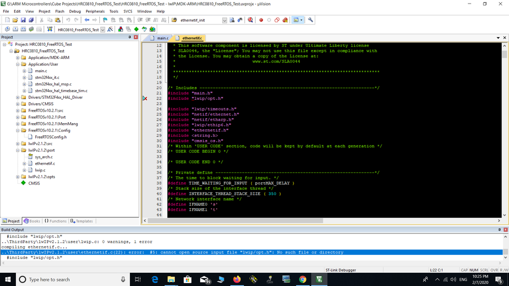

Dear friends,
I get a silly error " No such file or directory " in Keil IDE while I've already added the file path to include path directory of the compiler.
This error happens only when I add lwIP source files to my project.
And what's surprising is when I remove the path in include code, the error is gone. For example, when it is written #include "lwip/opt.h" , the compiler take this line as error but I remove "lwip\" from it and write #include "opt.h" there is no problem.
Can anyone help me with this problem?

Stop specifying the full path in the "Include Paths". Currently you have it looking for ...\src\include\lwip\lwip\opt.h
Thanks for your quick reply.
The error is gone now. But I face a new error which says " error while writing browse file: No space left on device "
Could you tell me what this means?
The hard drive or temp directory is full? Do you have a small SSD or System Volume?
Yes, there is only 425KB left. Is it just because of small volume I have?
